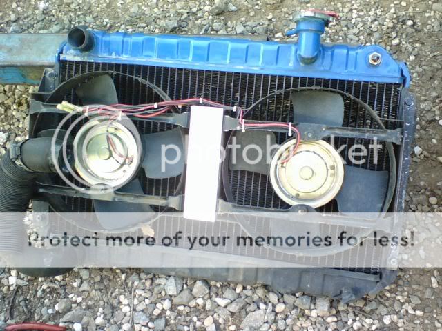

the condenser i use is not a bolt in. not to many of my things go in that easy. its a fab. make fit type thing.
the side wings under the core support have to be cut out on the pass side for air flow to the cores. i also made my own line from cond out to drier in and used a std, #6 x#6 (o-ring) drier that is easy to get and not as costly as "the proper unit"
it was a theroy that proved out right, that cause 134 expands so much more then r12, and oem was moveing to big cap condesners. so i found one that almost fit and had more volume the the 75,6,7,8 units. helped lots.
same with rad. i had a bigger hole, so why not go to the bigger rad.
so you can see the extra size on the cores. from the filler neck over is all extra over the oem size.
i think i did the math way back when, and it was something like 8 or 10 % more on both the rad and cond.
