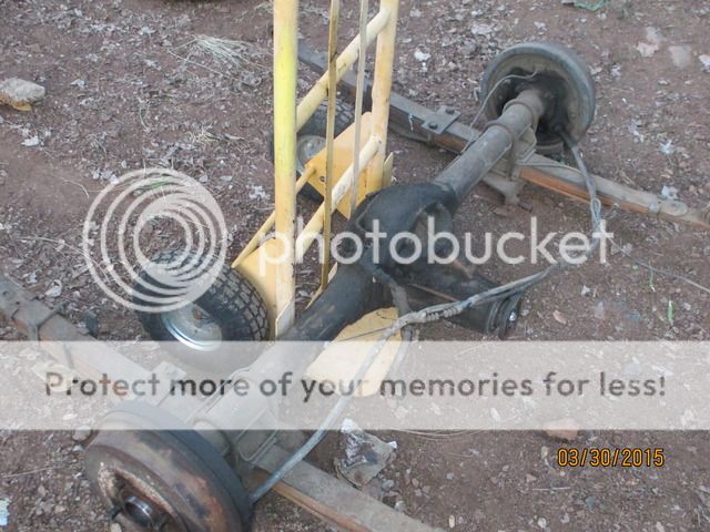

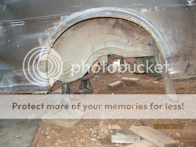

Post by Crash_X on Mar 31, 2015 17:56:18 GMT -8
ok, so its been a rear end couple of days. pulled 2, hung one back in (to roll it later). other needs cleaning and all that crap. dont seem like much, but the 1 going in is from a early-mid 70s corona. 1 inch wider then the TE51 axles. i have found that axles from the early toy vans with 4 lug are the same bearings, seals and splines as mine. just have to cut off some. but that is under another place in here some where. yep, those arnt oem springs ether i have done some weird shit with them. but i will get to that later so, nothing like rippin the ass out of the old girl!!! but she has always liked it rough thats 800.000 miles of hard ass. i havent had the rear out in at least 500.000 miles
