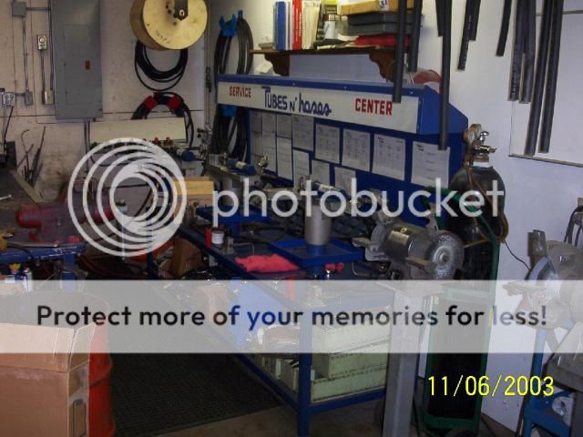

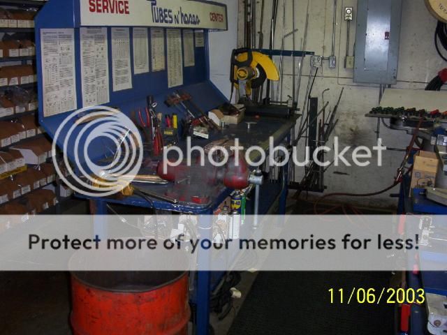

Post by Crash_X on May 13, 2013 18:57:23 GMT -8
this is my old girl in the shop. blue box and red cart are mine you can see all the hoses and rads and condessors behind my car. and that is less then 1/2 of one wall and not enough to count of the other wall. this was my tubes and hoses station spent alot of hours there
